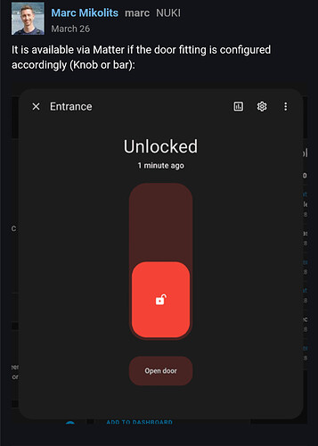

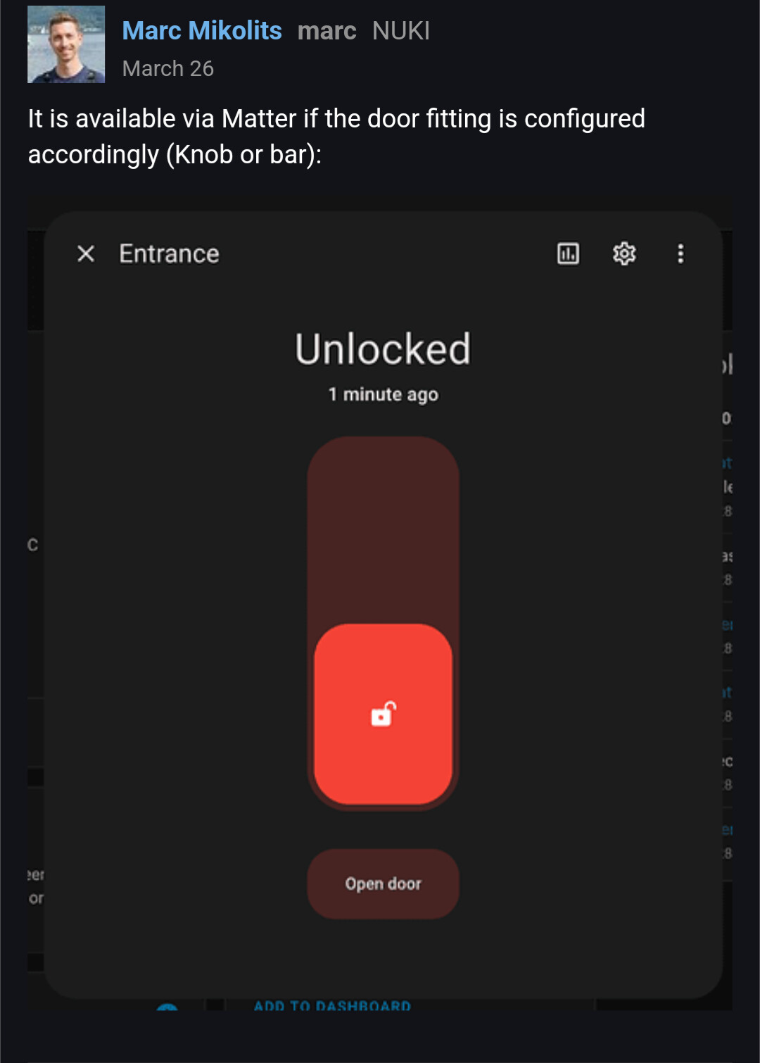

Finally got my Ultra, but disappointed that I can’t open the door from Google Home. The “Choose Door Fitting” is set to “Knob or Bar”. It looks like @marc shows that it is possible. How did you achieve that, Marc, please?
Yes, this (the “Unbolt” Feature) is part of the Matter specification but so far only the Home Assistant ecosystem has implemented it on their end.
For the other ecosystems it’s up to them when they’re going to implement this part of the Matter specification.
If the feature is not implemented (and there is only a “Unlock” button in the ecosystems UI) the Smart Lock will Unlock or Unlatch based on the “door fitting” (Knob or bar will always Unlatch and the others will always Unlock).
