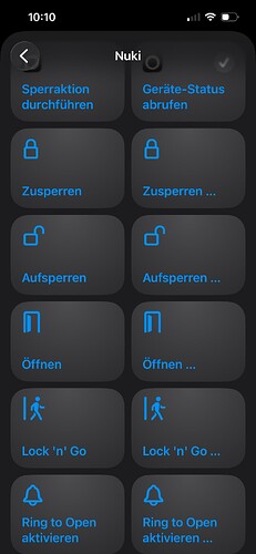

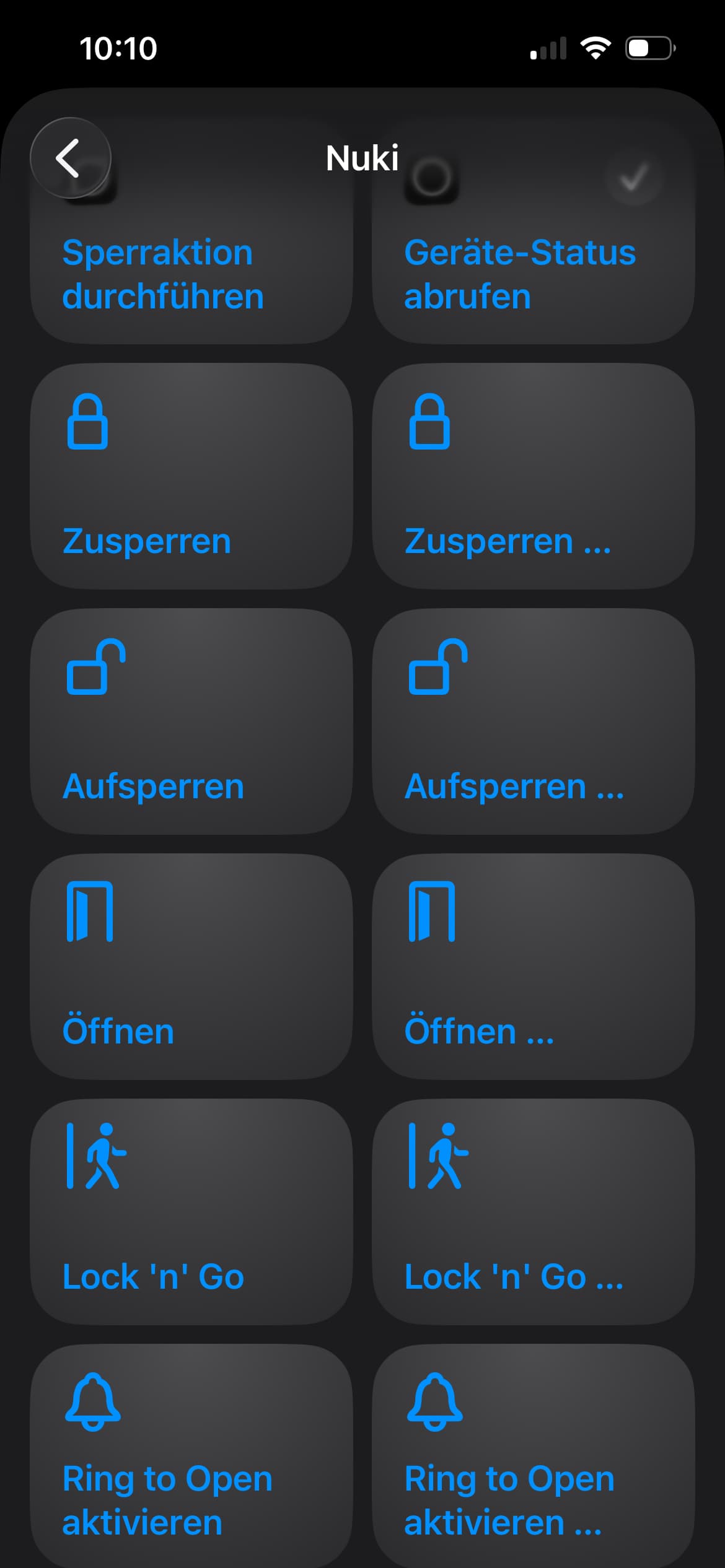

If your team would ad the option to “abort the search” to the items i can choose from
in apple automations. Than one could build an automation to stop the search quite easy.
