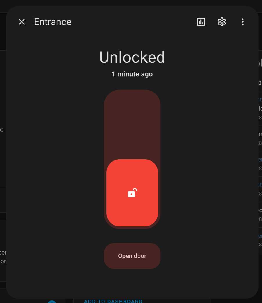

I have paired a Nuki v4 with a ESP32+Nuki hub, all options are available. Also detailed info about battery, voltage, WiFi and bt strength, you can enable/disable led, button… but there is a small delay updating info when lock is managed with the app or manually.
With matter only lock and unlatch and battery info. With matter lock info is updated instantly.
Do we know why the Open Door function is not available over Matter? I thought the point of Matter was to make IoT devices play nicer together.
