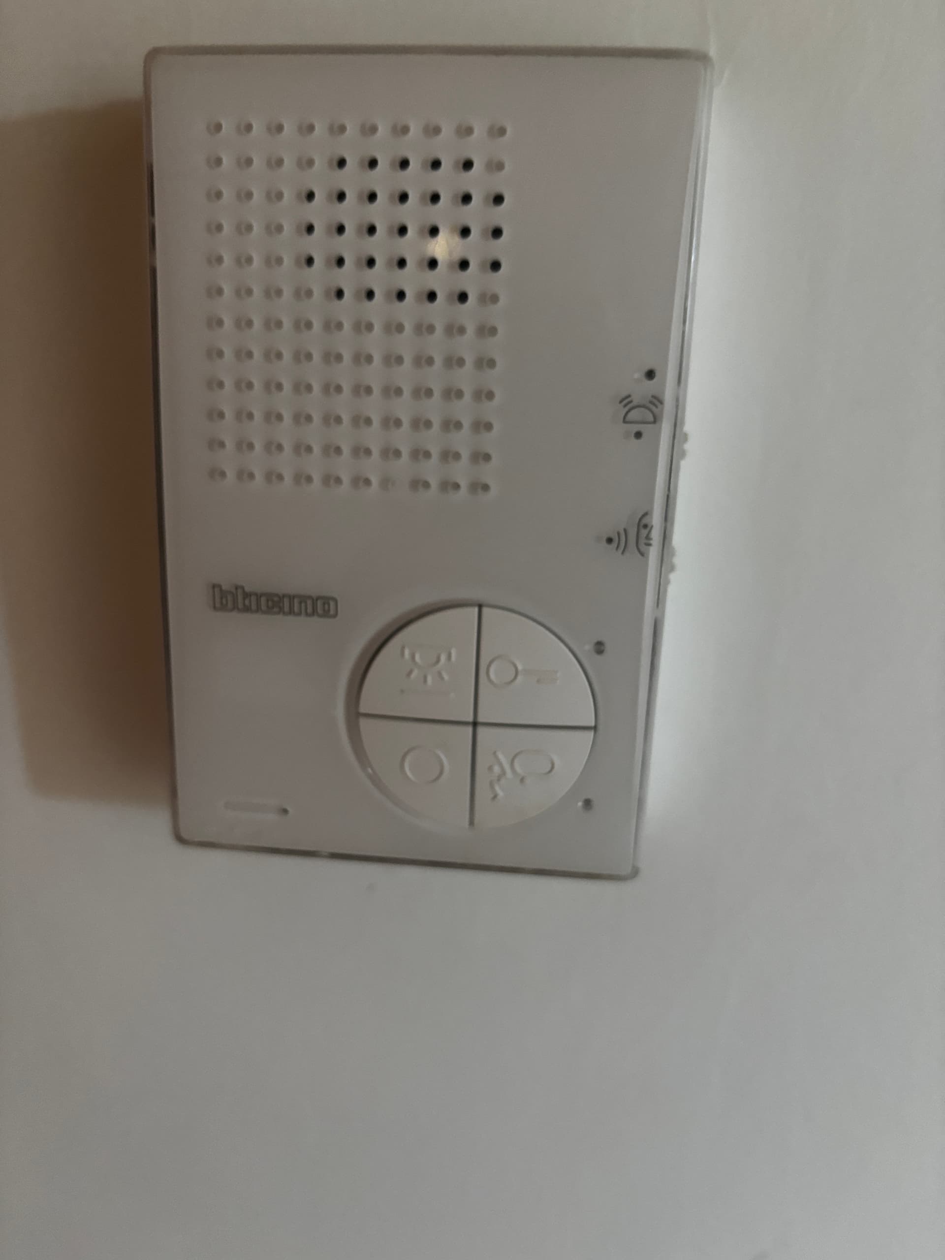

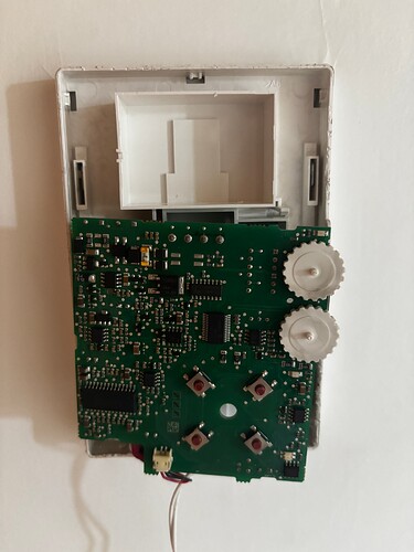

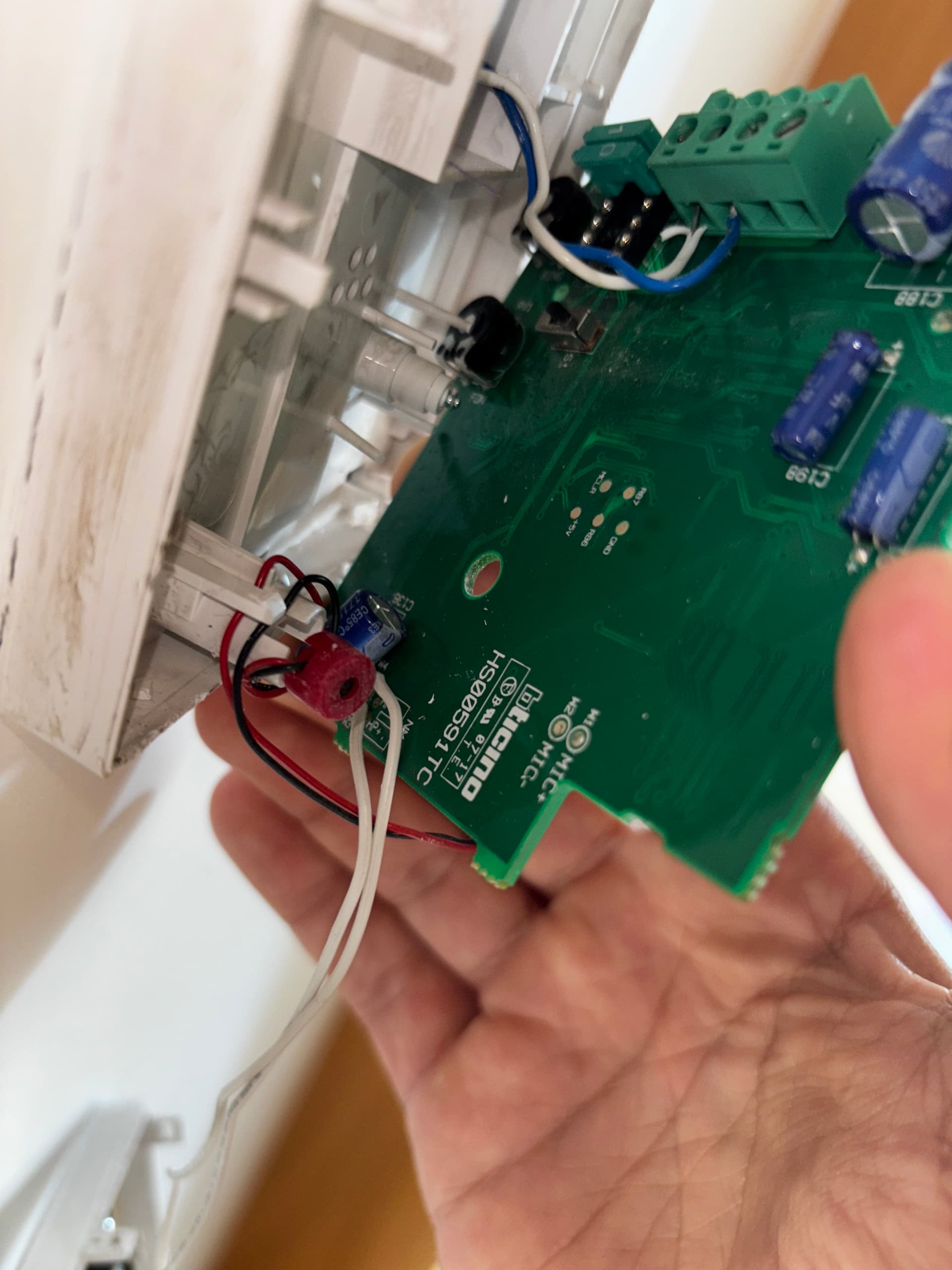

Hello everyone! Anyone else has this intercom from Bitcino ? I can see a number HS00591TC on the back, not sure its the serial number since I cannot find it either on nuki compatibility test or ring.
Anyone know if this would be compatible?
Intercom is audio only, and open two doors downstairs.
here is a pic of the front panel
Hi Baran,
i have a solution!
Select - Generic - Bus Bticino (Beta)
Red & Orange from Nuki to the White cable and Black from Nuki to the Blue - or switch.
So it worked for me!
