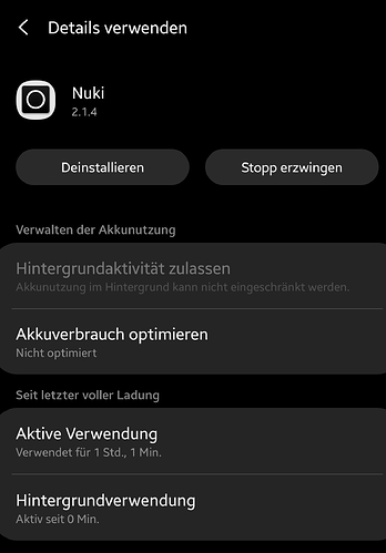

At least if there is no other “hidden” setting for app optimisation other than this:

Same for me, also using a galaxy s9. Auto unlock worked in a few cases after upgrading to pie. I have the feeling it works when the screen in the attached image isn’t shown when opening nuki over the status bar. I will send a debug log later.
