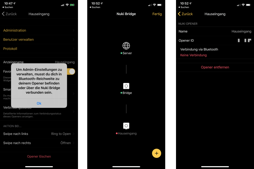

Since Opener Update v. 1.4.3 can't connect anymore
Since Opener Update v. 1.4.3 can’t connect anymore.
App is showing “not reachable” and trying get into Adminsettings I got an Error that I’m not in reach of Bluetooth.
But of course I am. The same place ever on my desk close to the Opener and even the Bridge. :man_shrugging:t3:
Any help is much appreciated.
Same here… no connection between bridge and opener since updating the firmware yesterday.
I now got back and forth in the Nuki App. Unplugged the Bridge end re-plugged it to the power.
Then I pressed the button on the Opener to did an action, in my case ring-to-open on/off.
After a few seconds the Opener was reachable by the App again and also possible to get into Admin settings.

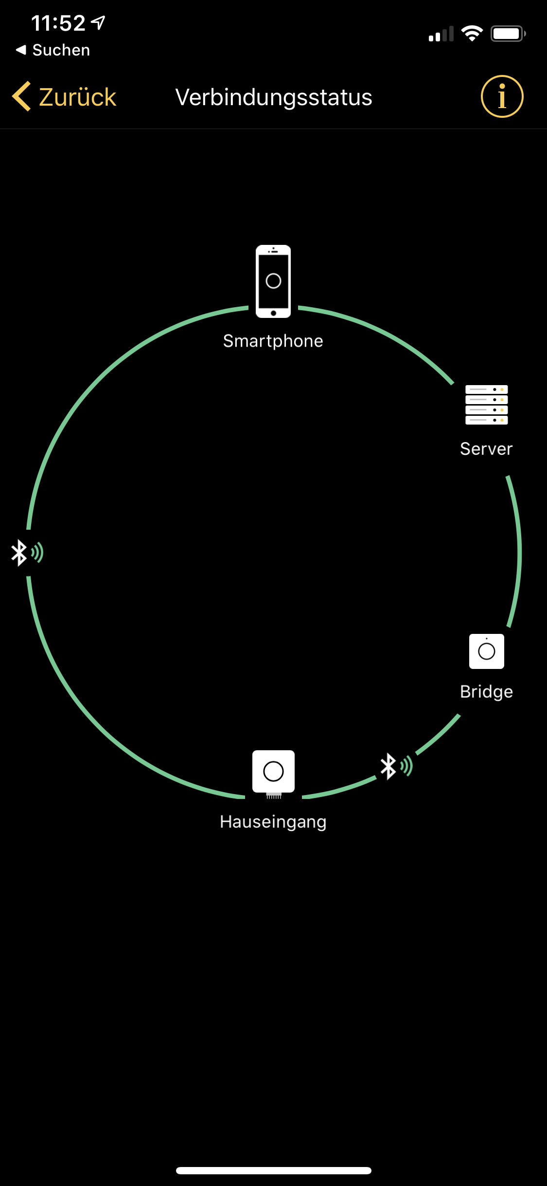

Connection-Status is looking good for now.
Replug the bridge does not work for me.
But now everything is working after deleting the opener in the app and add it again.
