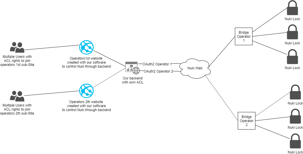

I sketched it again below.
For example: Our registration system -installed on a operators website- would like to grant access for a customer. In that case our system will grant access to a specific sub-site . This site has access rights to the Nuki Web (OAuth2) stored in the backend to control the locks stored in the account. The fact that the users granted by the registration system have rights to the sub-site means that they can control the locks.
We have now clarified that it is technically possible.
But is this also compliant with your data protection regulation and your general terms and conditions?
Any hints?
If you share the access token it is your part to do this securely and communicate this behaviour to the users and/or Smart Lock owners who share the access with you.
Though I can give you no legal advice here: We have no control over what you do with the shared access and so can and will not enforce restrictions on how you use it. From our view it is up to the Smart Lock owner with whom access is shared on what conditions.
