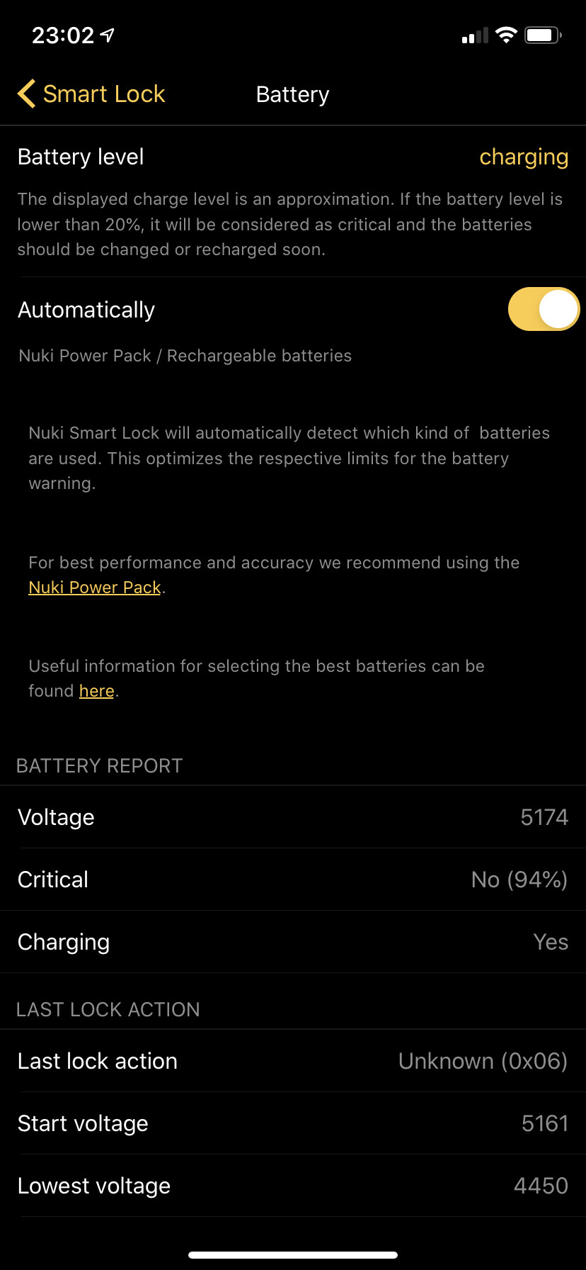

When i want to check my battery level it said:
Charging.
Is this normal? Because they are reachable batteries but they are not charging in the nuki:)
The old batteries showed me percentage in the colum : battery level
Now I guess i can only see the percentages when i press 7 times on the text. Did i do something wrong by putting the batteries wrong, but than i wiuld think the nuki wouldn’t work.
Any one knows that this is normal?
I’ve had this too. The batteries were nearly depleted at the time - once they’d been recharged the percentage came back.
Below 20% it just says critical and no %tage. Reason is that it‘s impossible to determine when they will ultimately fail to lock/unlock the door. Could be at 0% or 15% depending on many factors. Rather than waiting until this happens you better change them when they become critical.
