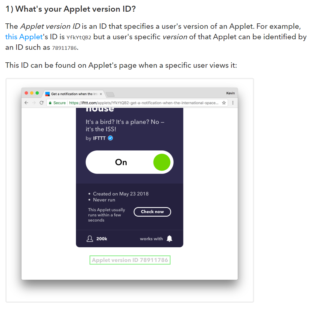

  • Do you have an Applet version ID for me? (not the general Applet ID)

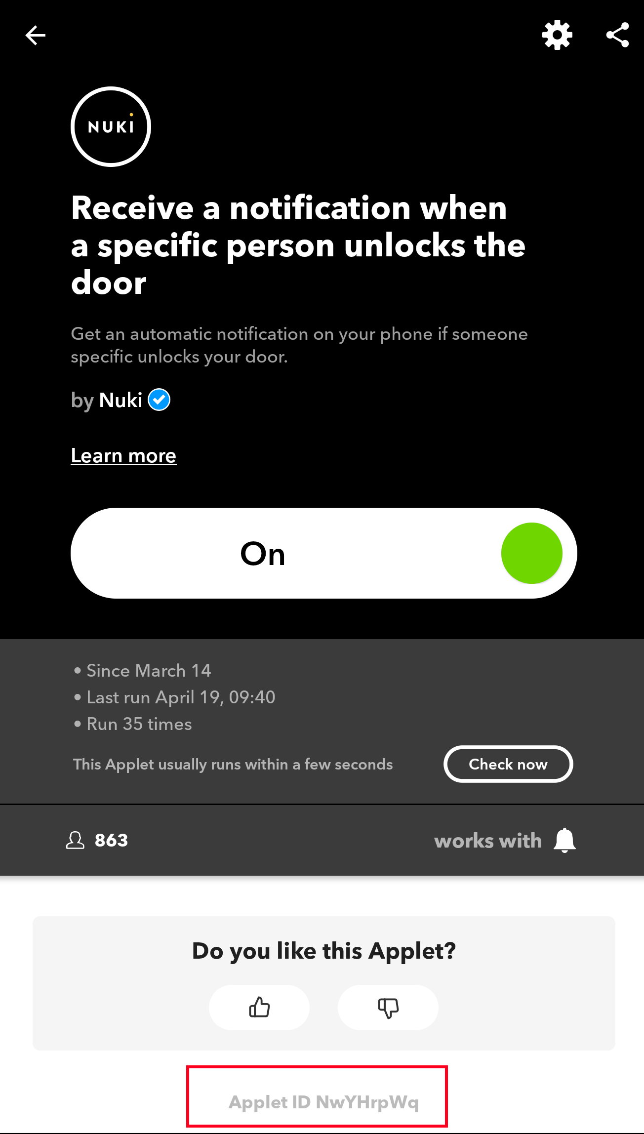

  1. Applet ID NwYHrpWq. Same thing with applet VeuK6LsN - both official applets created by Nuki as far as i can tell.

The IFTTT Applet ID is as i wrote in the previous message:

As you suggested I just created an applet manually that does the exact same thing and has the exact ingredients and the notification is displayed properly! Then i re-enabled the previous applet (Receive a notification when a specific person unlocks the door - by Nuki) and that creates the same error: {{Name}} unlocked {{Door}} at {{CreatedAt}}
So, the applet from the IFTTT store creates that error, the applet i made manually that is identical works fine. Beats me.

You have to open it up from https://ifttt.com/my_applets to see your (personal) Applet version ID (which is always numeric).
