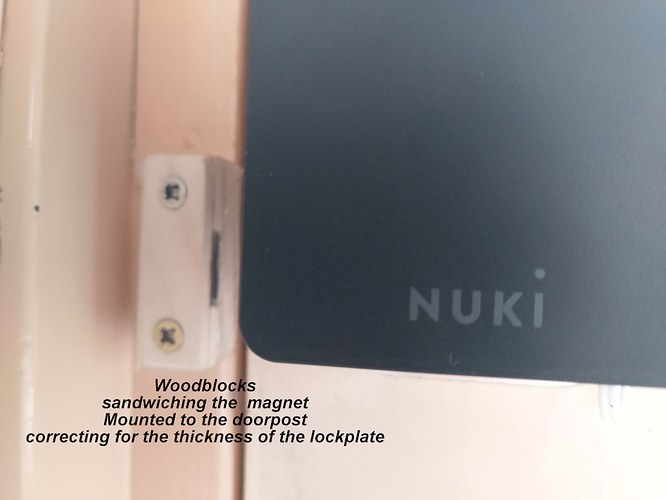

The problem did arise here to. The problem: Door sensor not accurate recording the position of the door. Especialy if the door is almost, but nog fully closes.
I have solved this by riseing the magnet a little from the doorpost by placeing it on a small piece of wood. So the magnet is more placed to the edge of the Nuki housing.
After re-calibrating the doorsensor the problem was solved. Even when only a creditcard space between open or closed door.
Picture enclosed shows the magnet place according to the Nuki.
