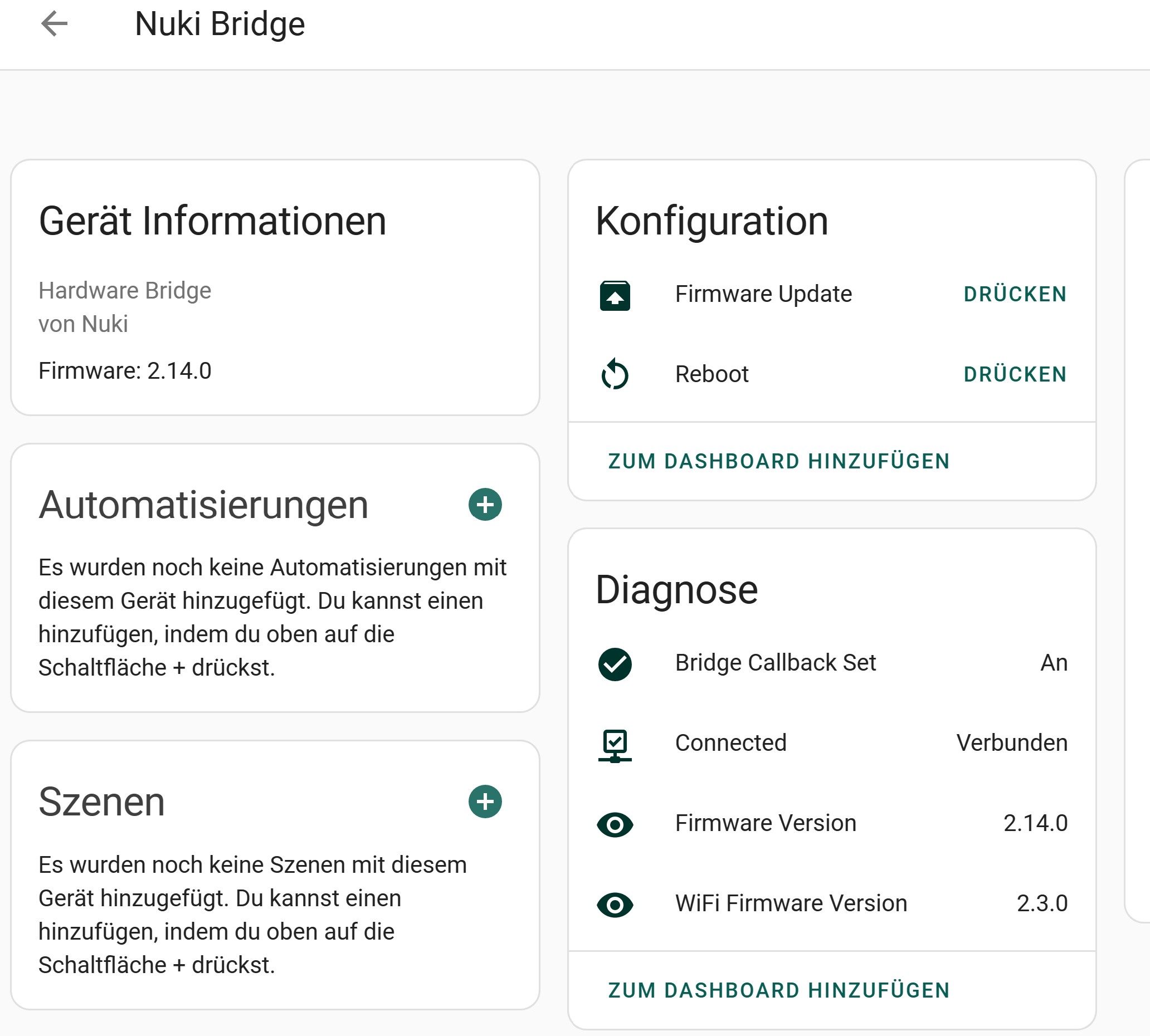

  • Check your brigde settings (see pic below)
  • make sure you have good wifi rssi values (I had some problems when the values went below 75) , so I relocated the bridge.
  • maybe a reboot of the bridge can help

It looks like perfect right? Or am I misreading the data? It takes 10-12 seconds to update in home Assistant… no clue why (I already rebooted
The issue does not happen if I control the lock via home assistant, but if I lock or unlock manually/keypad/Homekit it takes veeery long to update the state
